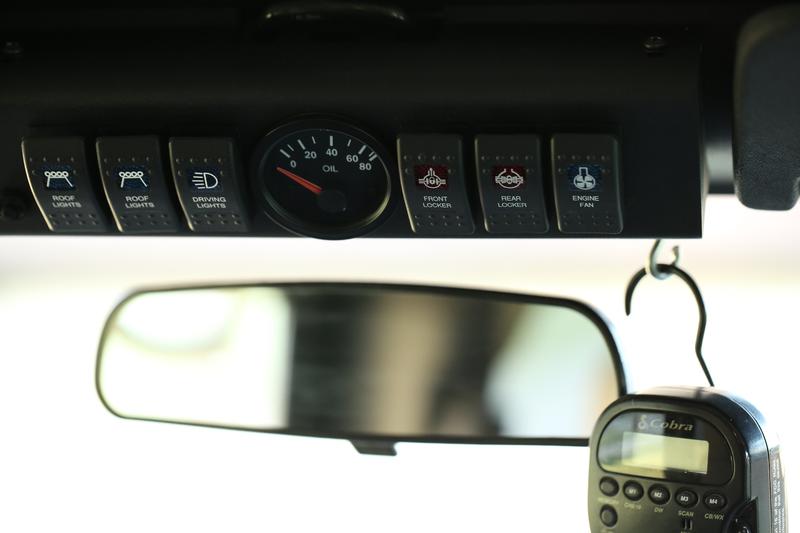

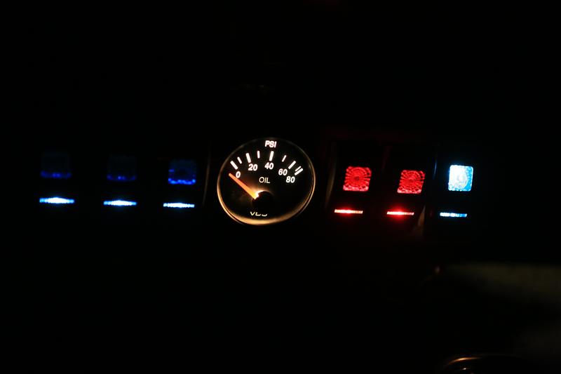

I did not use a GloShift gauge. VDO makes a gauge that is almost a perfect match for the stock Jeep gauges. Actually, they make two similar ones--one with a black bezel (X/Sport compatible) and one with a chrome bezel (closer to the Rubi's silver painted gauges). The gauge font and needle color are pretty darned close to OEM. My gauge is mounted in the sPOD controller above the rear view mirror. At first I had it directly wired to the power switch on the sPOD controller (bear in mind there are four different styles of Jeep JK sPOD controller--with and without a gauge hole and with and without a power switch). That meant full brightness. I didn't' find the gauge too bright. However, I eventually modified the sPOD controller wiring so that it would act as an "off-road configuration switch" for all of the other circuits. Since I wanted the oil pressure gauge lit all of the time, that meant rewiring it. So now it runs to the dash light dimmer circuit. Normally I have the dashlights set one to two stops below full brightness. The gauge is not too bright, even though now it's the only thing up there that's lit up for street driving. Here is a picture of it before I rewired the controller (IOW, full brightness) ...
And here it is in the daytime ...
Name:	Jeep Work, Sep 13, 5_9826, Engine Fan Switch.jpg
