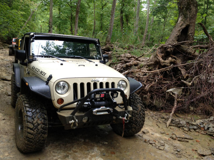

Hope this helps. These are 295/70/17 Trail Grapplers.

That 295 looks seriously wide. If I'm running 1.5" Spidertrax, am I going to get any rubbing with that width?

What lift? 2.5?

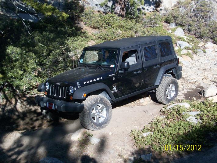

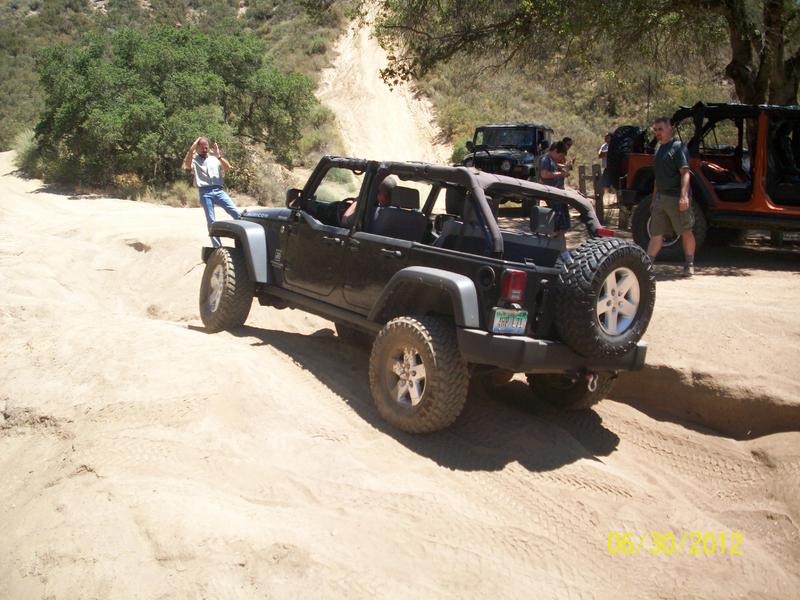

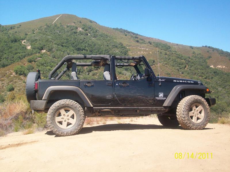

I have an UNL with a Teraflex 2.5 BB and 295/70/17 Grappler's and 1.5" spacers. The only rubbing I have is at full lock while backing up and it is just barely hitting the air damn, no worries.
Here are a couple pictures.
