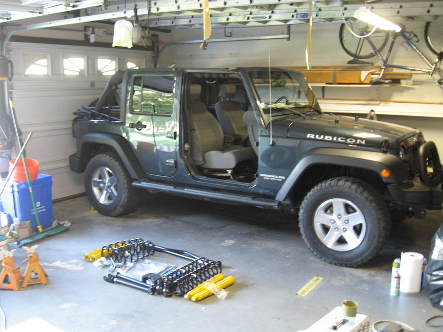

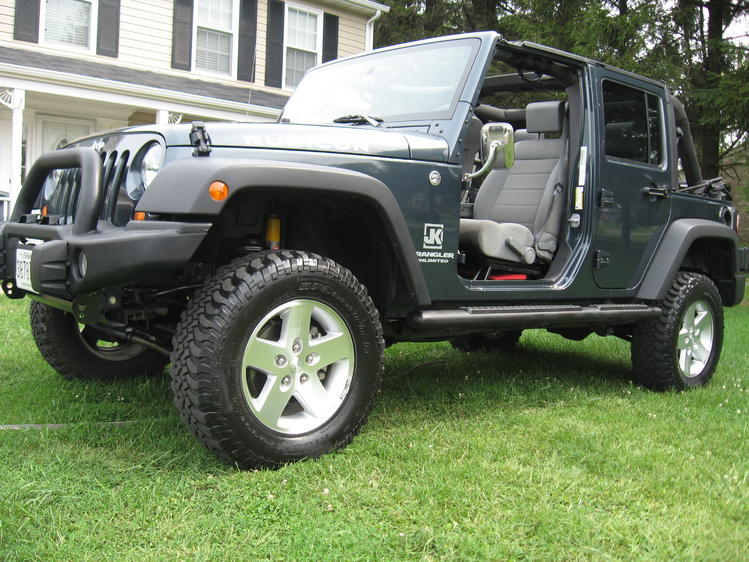

Default Just got done installing my OME kit.
On Wed and Thru I installed the OME LT HD kit from Northridge. I love it. The ride is great. This may be a "Frankenstien" kit but it is made up with the best of the best. Teraflex makes a great product but with the OME LIft you get currie control arms, sway bar connects, JKS front and rear adjustable trac bars, Brake lines, and the OME springs and shocks are about as good as it gets. However the ride may be a little to smooth for some.
A couple of questions, concerns, recomendations, etc.
1. The kit doesn't come with directions but the Project JK write up on the main page from when wayolif put the kit on NEMO is way better than black and white instructions from a company.
I have never put on a lift kit and I had no trouble putting it on.
I would have loved to have had some starting deminsions for the length of control arms, track bars etc. with an explination of why they need to be that deminsion.
2. Make sure you have Gear Wrench type wrenches they are a must.
Also either rent or buy coil spring compressors, they are a must.
3. If you don't have a Rubicon make sure you order sway bar disconnects.
4. I wish I had ordered the 1" teraflex pucks for the front and rear(with cone) instead of using the spring retainers on the rear. You will still need to use the lower spring retainer / washer on the rear. Plus it will give you an extra inch of lift.
