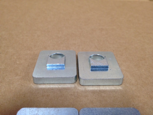

Here is some pictures of them .
They are more a cam spacer the bolt is not adjustable just a standard bolt all your doing is changing the spot the bolt is in the bracket. Adjustable lower control arms would be best of course.

Once those are placed in the hole it leaves a small portion of the mount showing. That is what you trim off

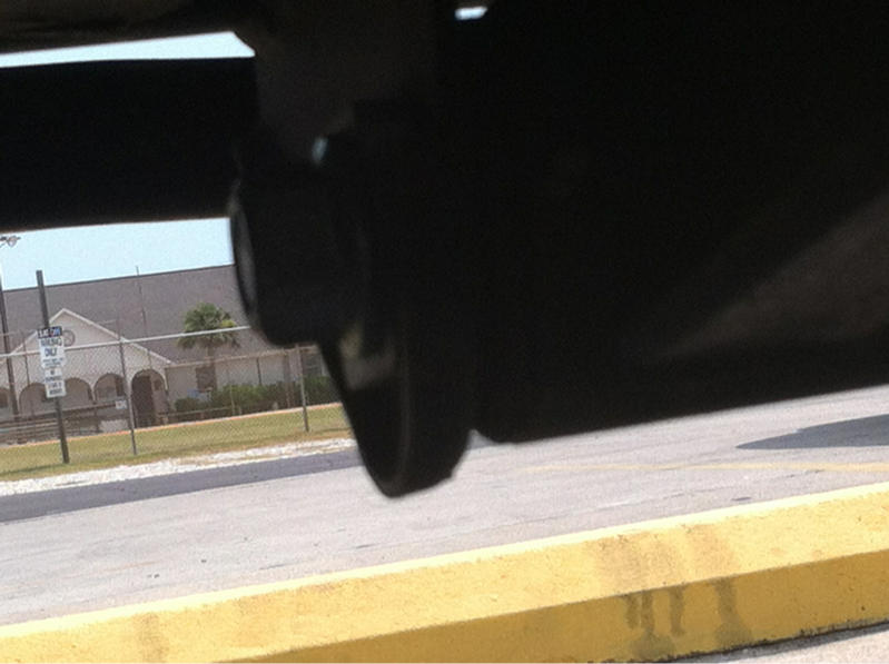

Here you go. Hopefully you will get the idea
