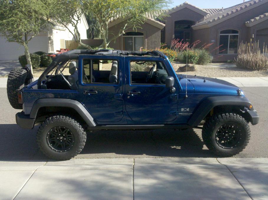

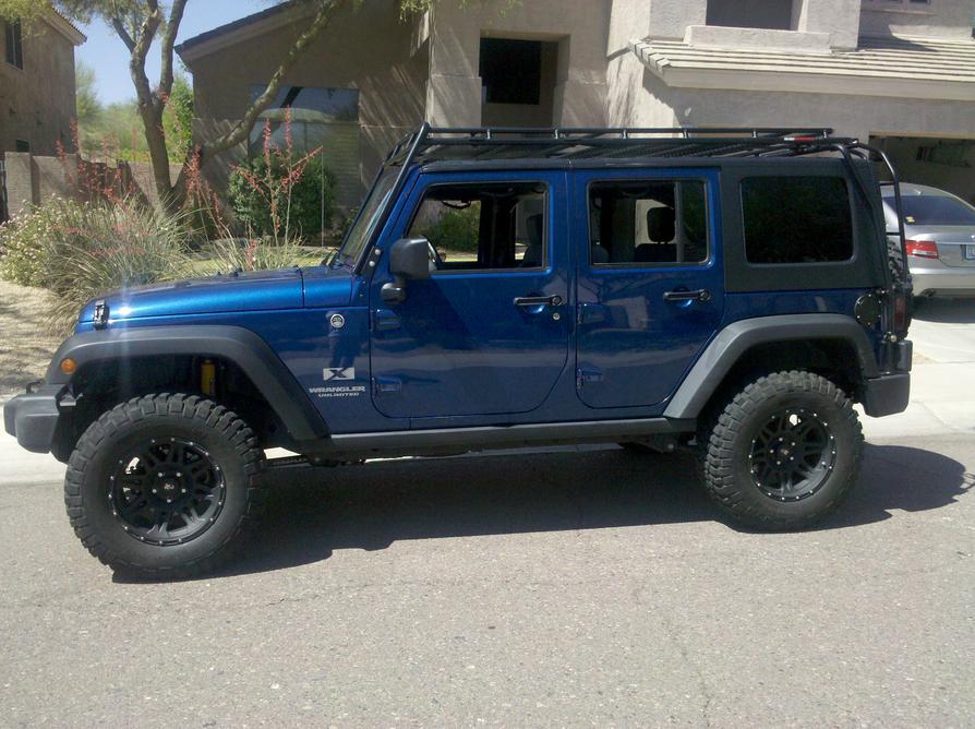

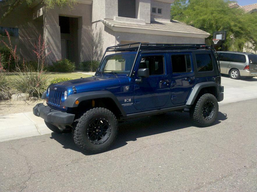

I have the unlimited with OME light duty 2 inch coils. They are great with 33 inch tires, but probably too smally for 35 inch tires. They ride nice, but as soon as you start adding weight they sag. (by weight I mean camping gear and family).
If you ever have any intention of bumpers/tire carriers or a lot of other extra weight jump up to the heavier coils.
