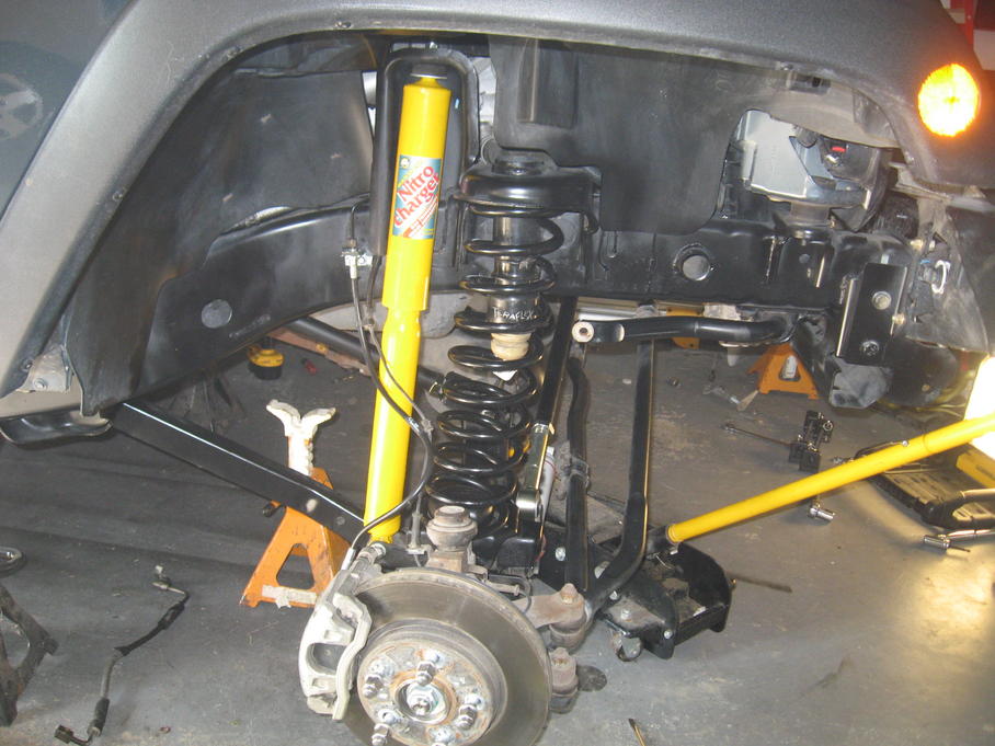

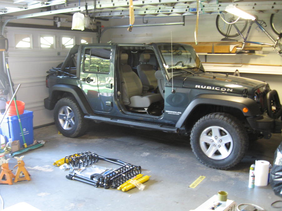

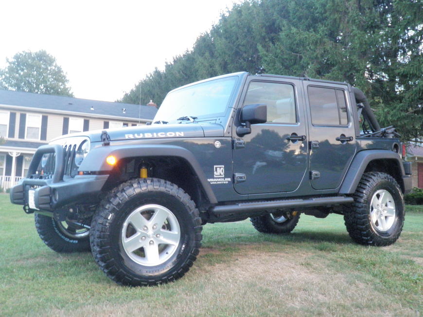

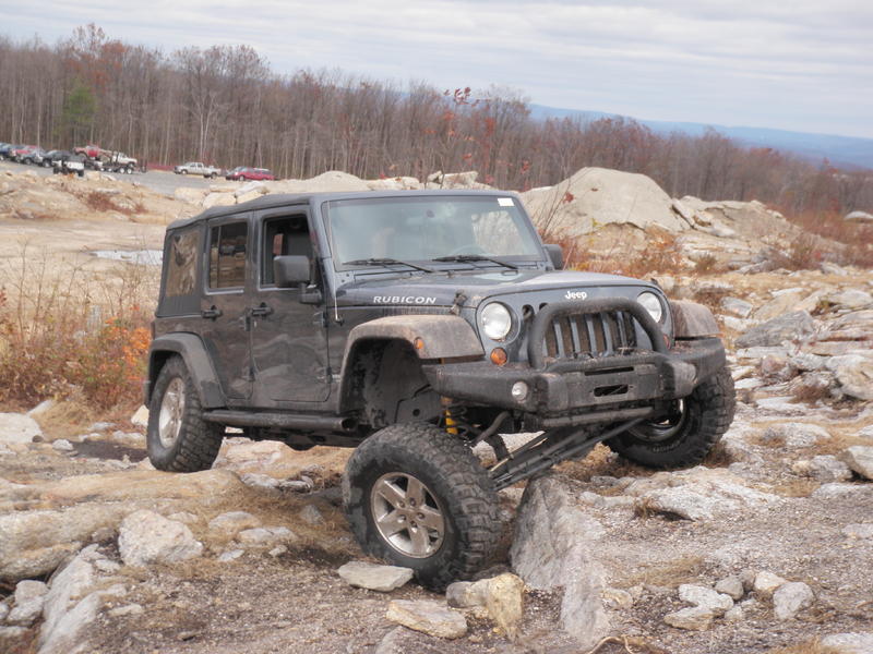

Big fan of this lift. It performs great both on and off road.

That's the 2" kit? Nice droop!

Nice flex!
