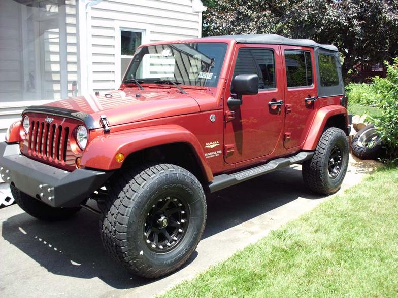

Overall same OME here. The HD springs gain you a bit more than 2". Even after I swapped bumpers it still sits well.
Trackbars as everyone suggested are a good idea, I mean if youre in there doing the lift, you may as well get it all done. The only thing I added beyond that was the OME stabilizer with the relocation bracket.
Best of luck!
