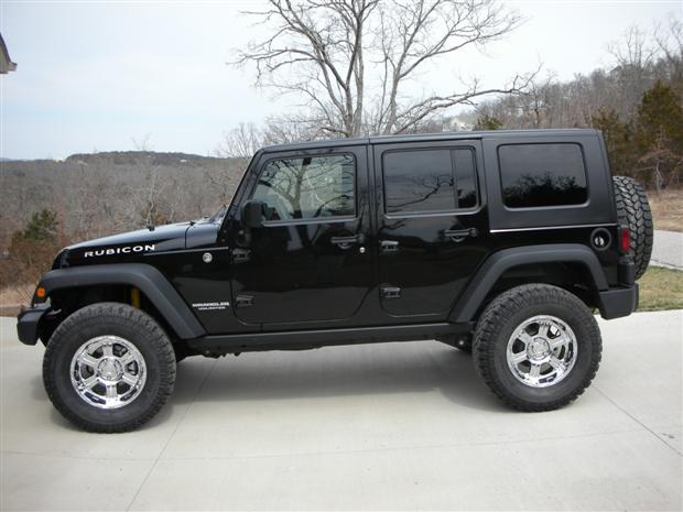

Old Mar 9, 2008 | 10:32 AM
rp41's Avatar
Posts: 81
From: mo
Originally Posted by xldme
Here you go
Name:	4doorjeep 004 (Custom).jpg
Old Mar 9, 2008 | 05:02 PM
Bill's Avatar
Joined: Sep 2006
Posts: 112
From: Markham
What size are those tires? They seem to be a good size for the lift.

Old Mar 9, 2008 | 06:09 PM
rp41's Avatar
Posts: 81
From: mo
They are 325/65/18 which are 13.5 wide. They don't rub because the 4.75 BS of the wheel seems to be just right.
