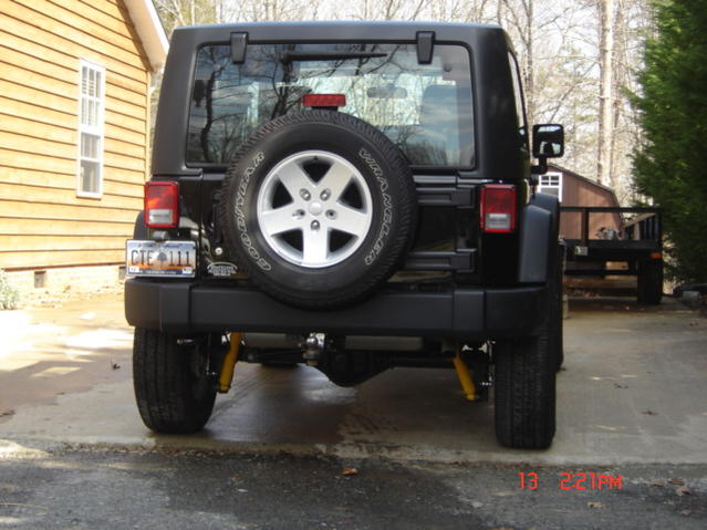

I have the OME HD lift with JKS front and rear adj. track bars from NR. Still have stock bumpers and rides nice. I do at some point in time plan to add new front and rear bumpers, winch, etc.
If you just plan on running 33's, which i might still do. it will be fine! Just get front lower adj. control arms, so you can adjust the caster.
