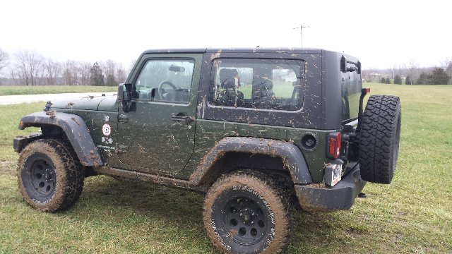

I have a 2 door jk with a hardtop. Stock bumpers with a warn m8000 winch and teraflex tire carrier. I don't have measurements but here's out it sits on ome 616 up front and 617 in rear without the trim packers (heavy front medium rear) with 285 16r tires. Hope this helps
