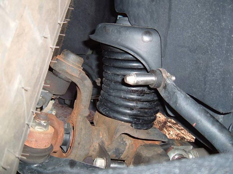

Originally Posted by jadmt
is it healthy for the coil to be fully collapsed? Only reason I ask is my buddy without bump stops and stock tires ends up fully collapsing his coils I was looking at it when fully flexed and told him he needed bump stops but if that is not an issue I will tell him. there was plenty of space fender wise but the coils were completely squished.
This is the pic I sent to ARB USA asking that question. They forwarded it to the head engineer at ARB Australia. He stated that you will not harm OME coils by fully compressing them, but did suggest that you should bumpstop to keep it from happening. I can't find the email now, but he added a bunch of numbers to prove that whatever metal they use is up to the task.

Originally Posted by Mr. Incredible
Back to the question, anyone think it looks lower in back or am I crazy?
Doesn't matter what we think or whether it is or isn't. What matters is what you think. If you think you need to raise the rear a bit, add spacers.
For me, I was talked into HD coils up front (bumper and winch) and MD coils in back (stock bumper). The rear MD coils sagged very noticeably. Added an extra 1/4" to the rear, then they sagged again. Not really noticeable when I had the chopped factory flares on, but I can see it with the soft top and un-cut flares, and it is very noticeable with the hard top and un-cut flares.
