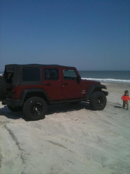

Ome HD lift with JKS front and rear adjustable trackbars. No spacers.
Tires are 285/75/16 duratracs.
Lift gave me 2.5" lift in front and 3.0" in rear (measured from center of hubs).
Rude is a great. Harder than stock and stable.

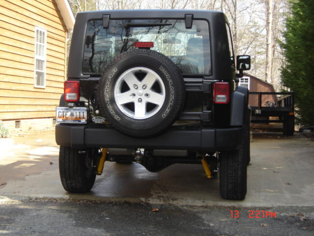

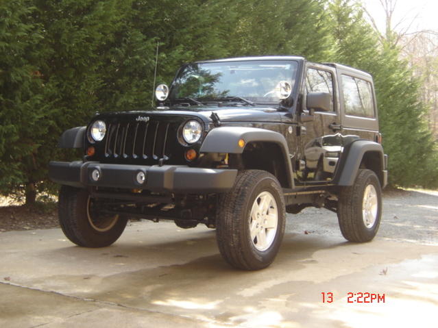

Love the lift(3-3/4") on my all stock 2 dr. Ride is stiffer but not harsh(OME HD + OME shocks). You will need with any lift of this height, rear brake line ext. and rear adj. sway bar links. I also have JKS F/R adj. track bars. And will bet getting new Coast F/R DS soon. Then 35's and gears!

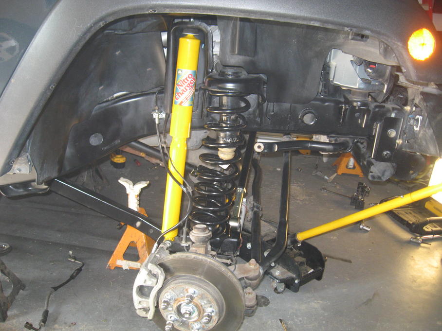

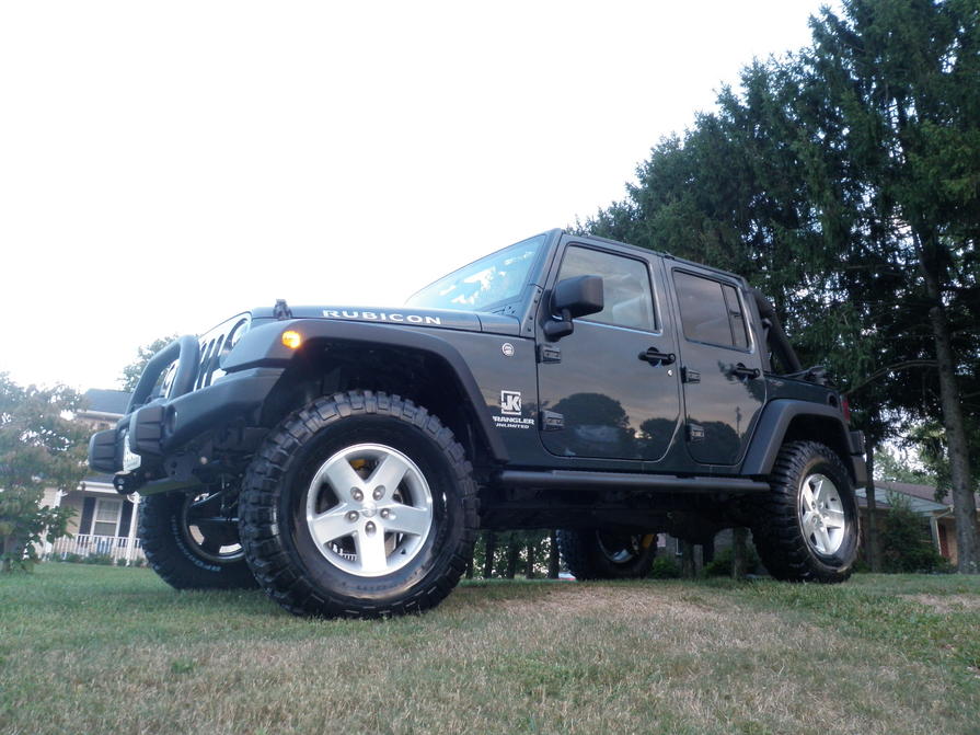

OME LT HD. Got it from Northridge.
