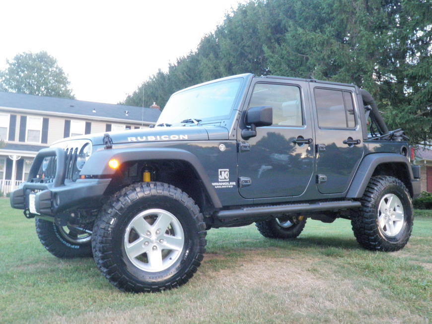

Trust me get the OME with HD coils. The Ride is better than stock and if you get the complete kit from northridge it is not overkill it just gives you everything you need. I recently helped another forum member put the ome lift on his jeep but he elected to piece it out and get the control arms, brake lines, and a couple other things at a later time. He has been having alignment and flighty steering issues. The jeep is his daily driver and he can't wait to get the control arms done.
Just remember,
You get what you pay for! and Do it right the first time! If its a money issue you are better off waiting and buying a complete kit.
Not to mention the more than complete write up / Install instructions on the Main JK page.
