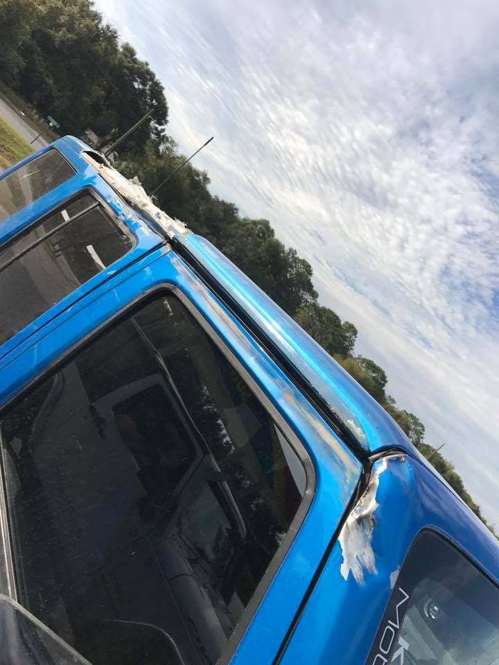

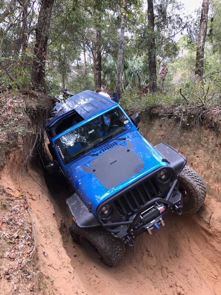

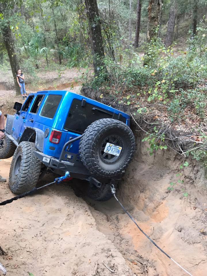

Well....Yeah! Not much else to say about that. I've only had my Jeep for a couple of years so it's still a learning curve...
Case in point...
