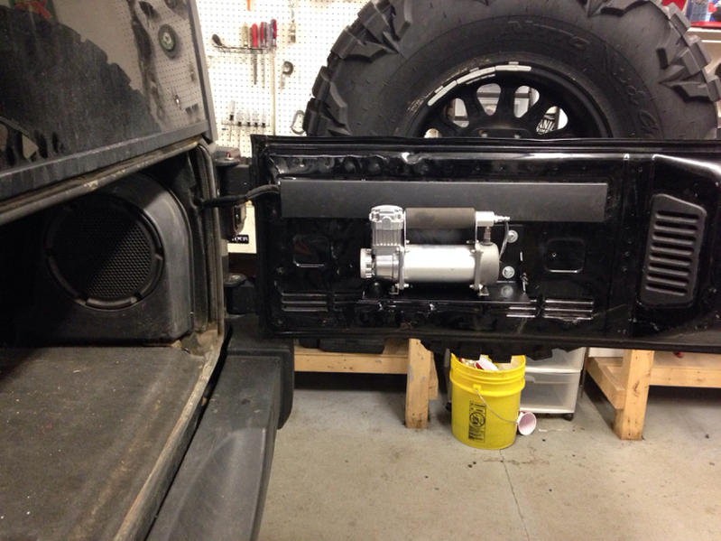

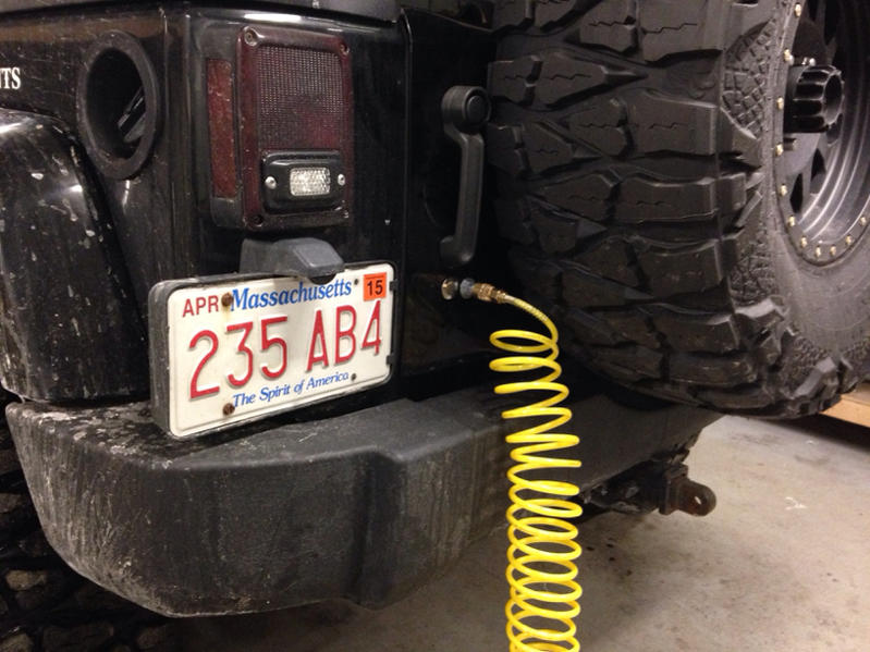

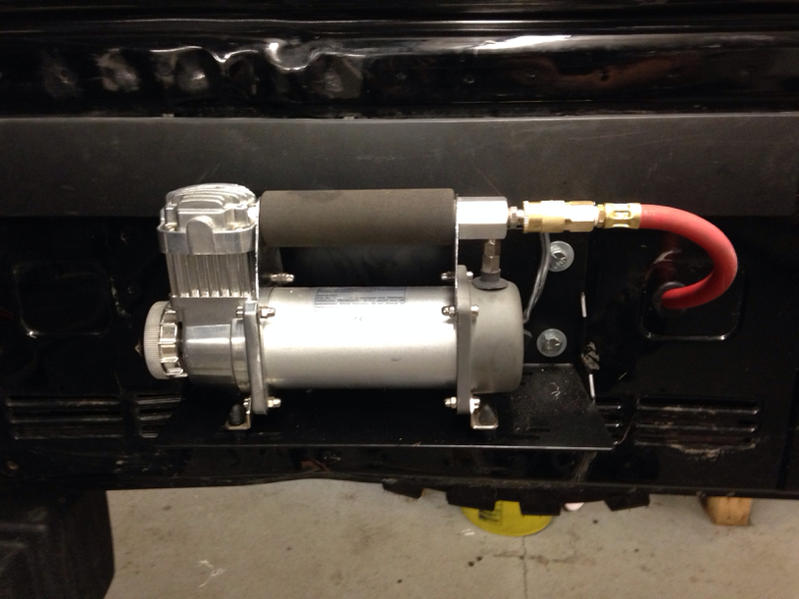

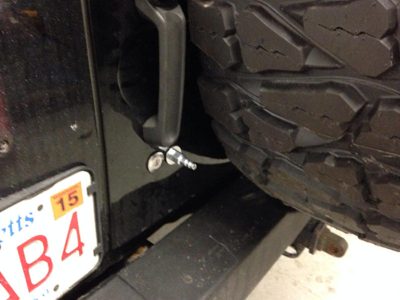

Here's my setup

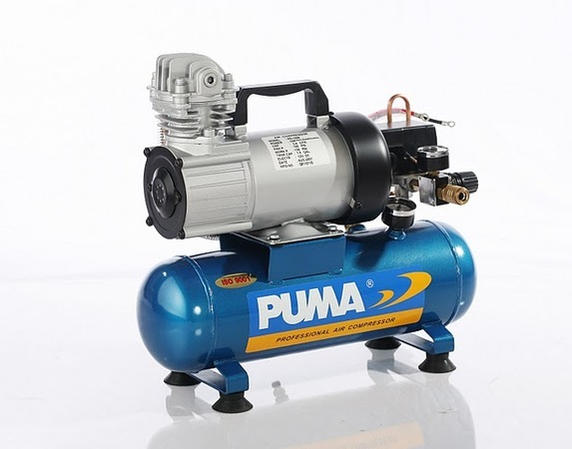

I have a Puma 12V. Not fixed mounted, but very fast. Central tire inflation would be cool though!
