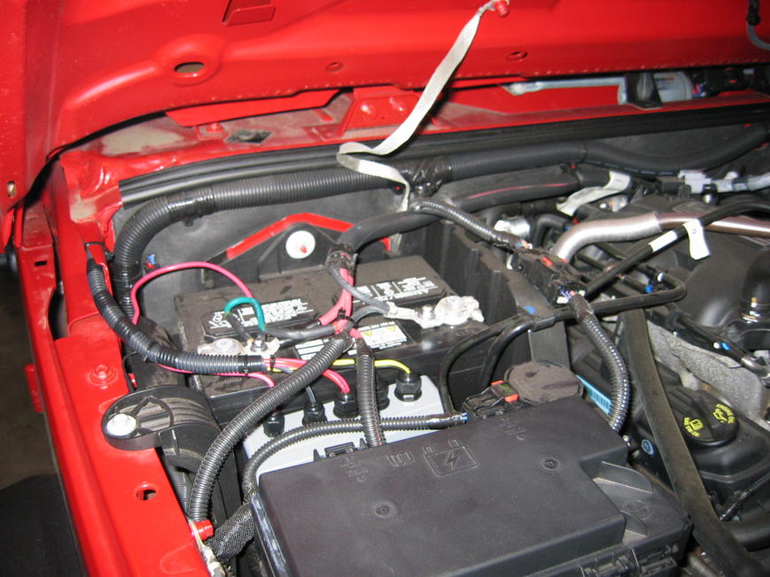

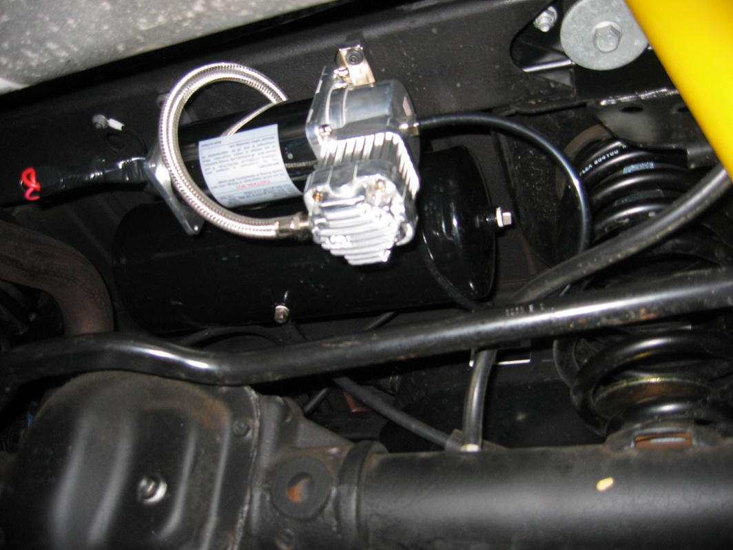

I'm a bit late but here is my setup. I mounted a 2 gal. tank and a Viair 380C compressor on underside of body/frame above rear axle. Made a custom swich/guage panel that houses the relays and pressure switch. Its on at 110psi and off at 150psi. Wiring ran from new fuse panel up front.
Pics attached.
Pics attached.
That's Cool!
Any problems with the viair and Water mounted in that location?
