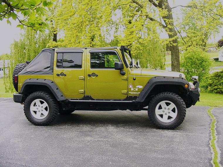

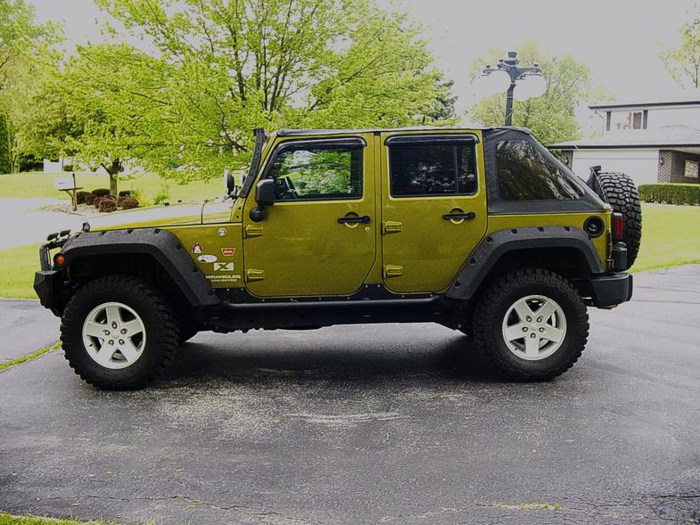

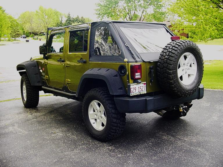

i did the same and and it will sit level (2.5" rc coil lift w/.75" front) i have highrock frt bumper w/ warn winch

I will say that my winch and winch bumper sagged my front end down by about .75"......so sounds good to me. And if for some reason you want to put the rear spacer in later it's easy to do later.
