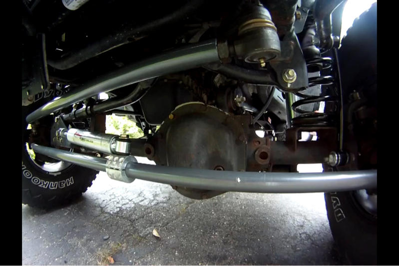

No experience with JKS, but installed the Synergy bracket and flipped the drag link recently. It works great, but it is designed around the synergy trackbar. (haven't followed any threads concerning fitment of the monster, so you might do a search on that just to be safe).
And no experience with either clamp, but was running the Synergy ss relo bracket with a fox ss and the stock clamp for a year or so with no issue. The big beefy clamps sure look cooler though.
