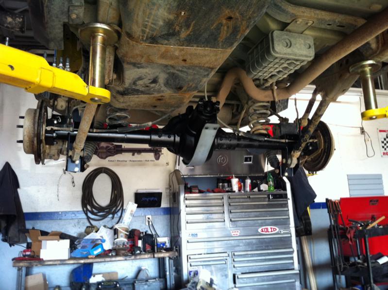

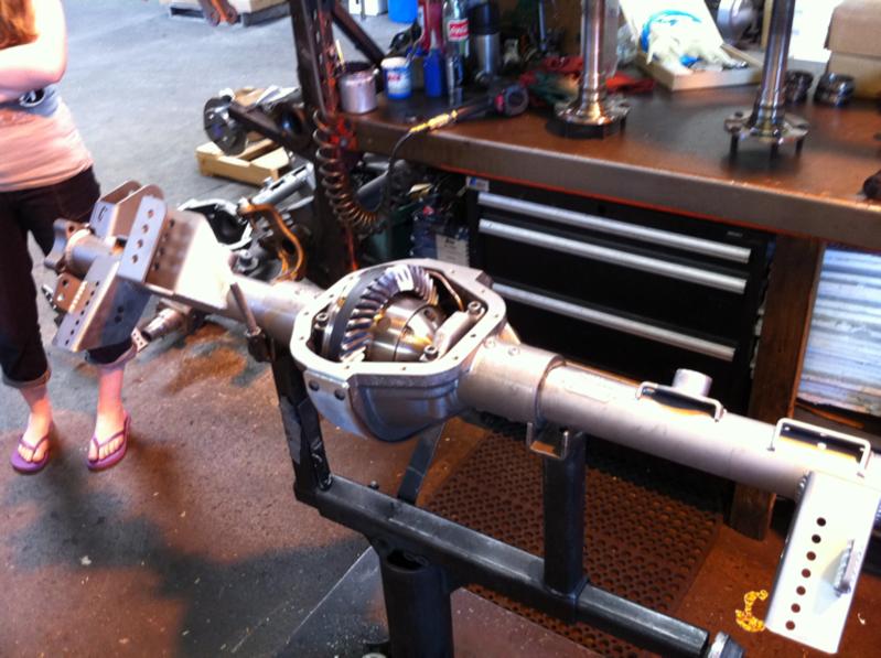

I have a Currie Iron Jock d60 with 40 spline shafts. Of all the Currie's running out there over the past couple of years in JK set ups, only one bent a shaft and that was (I think they told me) Shannon Campbell toasting the crap out of it with a 600 horse motor and I think that was a 42" mtr.. According to Currie no breaks "yet". Now that was this past March, maybe some breaks have occurred since. I asked them about the flange strength as well as Dynatrac with their's (Dynatrac does now have a full float). Currie sold me with their explanation of bearing placement and where the wheel weight actually put stress on it and not the need for a "full float" design. Bla bla bla, sales talk yes. In the end I did go Currie and I have definitely put it to use. The angled pig with built in skid has glided over the rocks as designed and the 40 spline shafts are massive and I just can't seem to think I could break one with my turd 3.8 even with the Rubicrawler's relentless turning of my rear on rocks. Mine is set up with 5.13 R&P and using the 40spline ARB locker.
