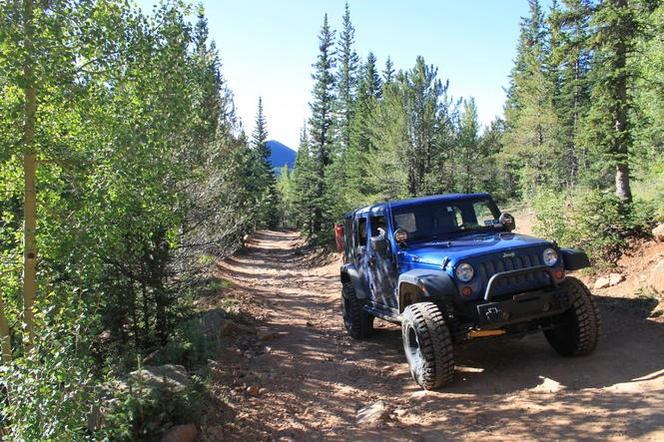

I have the AEV 4.5. It handles great on road. The high lift steering kit puts everything back in alignment from the lift. You don't need to ditch any arms with their drop brackets but you lose about an inch or so of clearance only on the front lower control arm mounts. You can always not use them and opt for any good lower control arms (I use both: drop brackets and Rock Krawler arms)
I have the MTR's as well.

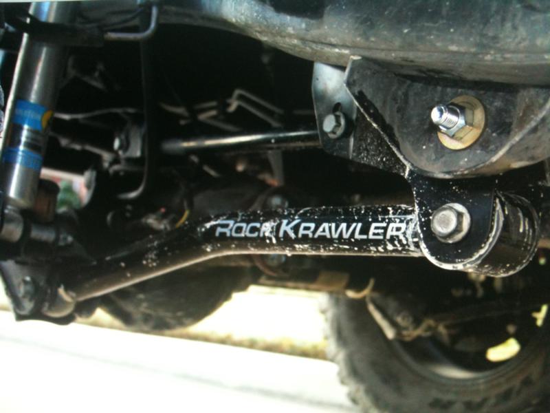

Here are the AEV drop brackets with Rock Krawler Front LCA's
