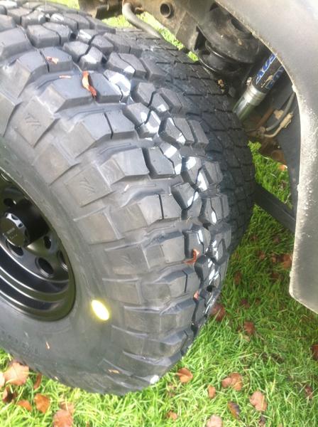

can see the rod on front (current) TeraFlex shock in this pic:
