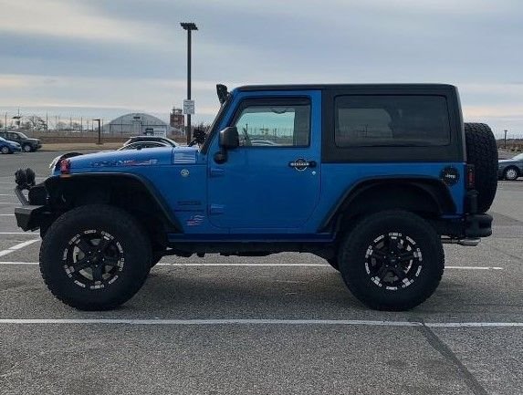

Hello folks,
I joined the site shortly after purchasing a 2016 JK 2 door back in May. Had 27000 miles, priced right with many extras. Bumpers, 9500 winch, flat fenders, MB 17x8.5 wheels on 315/70 G2 Grapplers, and a few other things.
It has a lift using 2.5 - 2.0 Teraflex spring spacers front and rear on the stock springs with 5100 series Bilstein. All control arms are stock. Track bars are also stock. I do not see a front bracket however there is a frame side bracket on the rear. Sway bars are level so assume when lifted, the links were swapped. Drives well, tracks straight, solid on the road, shocks seem a bit stiff, but has no noticeable bad habits. Overall, a clean nicely taken care of ride.
After researching some threads and putting some miles on it, the suspension could use some work to correct some install issues, improve the ride and stance, mainly to clean up the budget install. There may be some minor off roading/beach use in the future but mainly overlanding the Great Tundra of Long Island.
I believe the front stock springs with spacers are not happy with the added weight of the bumper and winch. The front is visibly lower. I assume the stock springs are not up to support the additional weight.
An upgraded 2.5” aftermarket spring should support the additional weight up front however to set the Jeep level, should I consider maybe a 1.5-2” upgrade spring for the rear?

Jeep looks nice now except (in my opinion) for the slight “nose low” stance. Once the suspension mods are done and the time comes for new rubber may look at wheel options.
