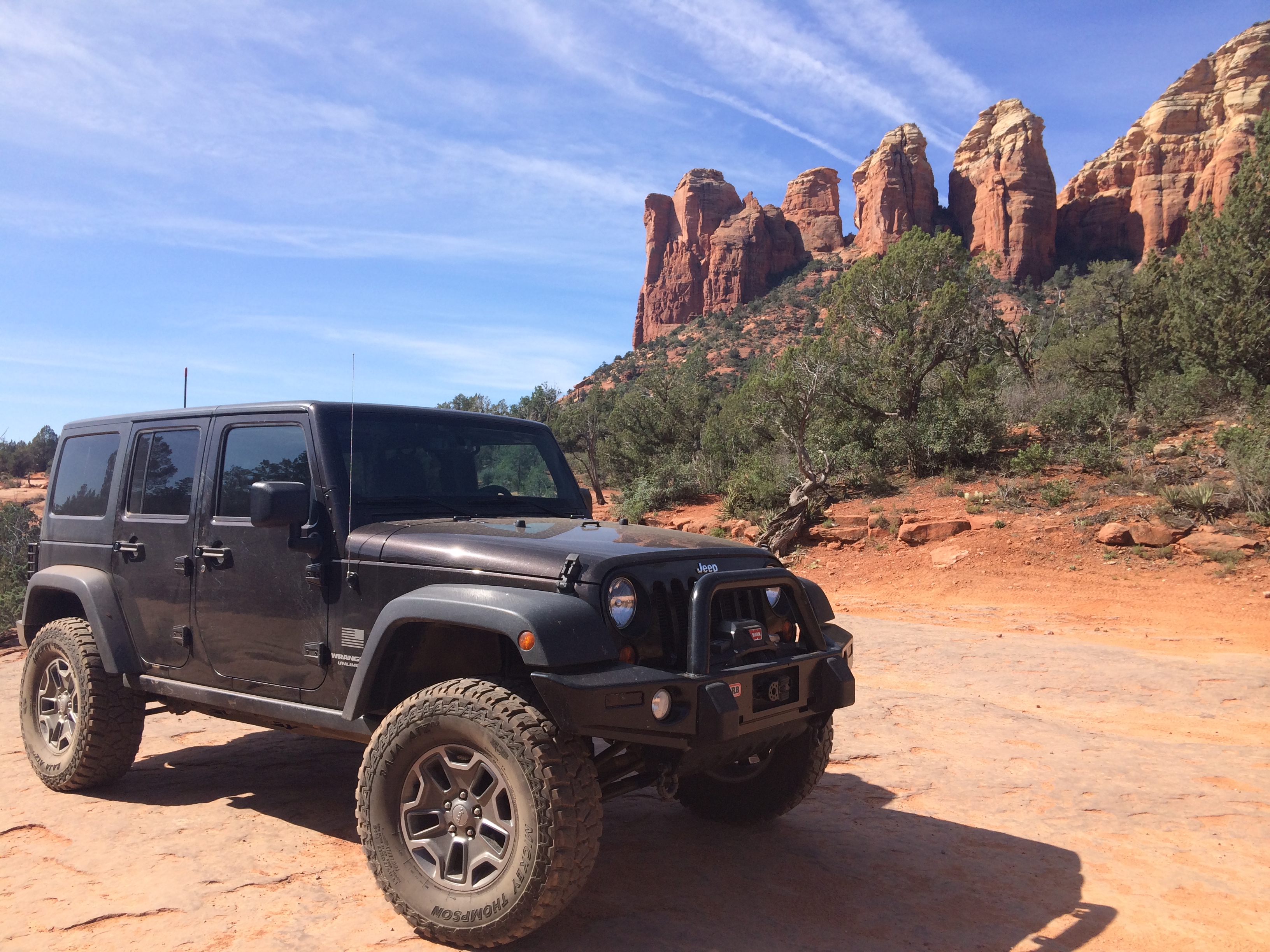

Don't really need much more than a 2.5"-3" of lift for overlanding unless you plan on running tires larger than 35" or just want the look of a taller lift. Even at 2.5"-3" with the addition of flat fenders you can easily fit 37" tires if the need arises. Once you go much over 3" you are going to have to add at least a front drive shaft to your build list and fair number of other goodies not included in the lift kits.
Between the brands you listed TF has the best balance of on road and off road performance in their lifts followed closely by AEV IMO. I run a 2.5" (3" real world) RK system and 35" tires on our overland style JKU. If I had to do it over again I would go with TF. The RK system is overkill for an overlanding Jeep.

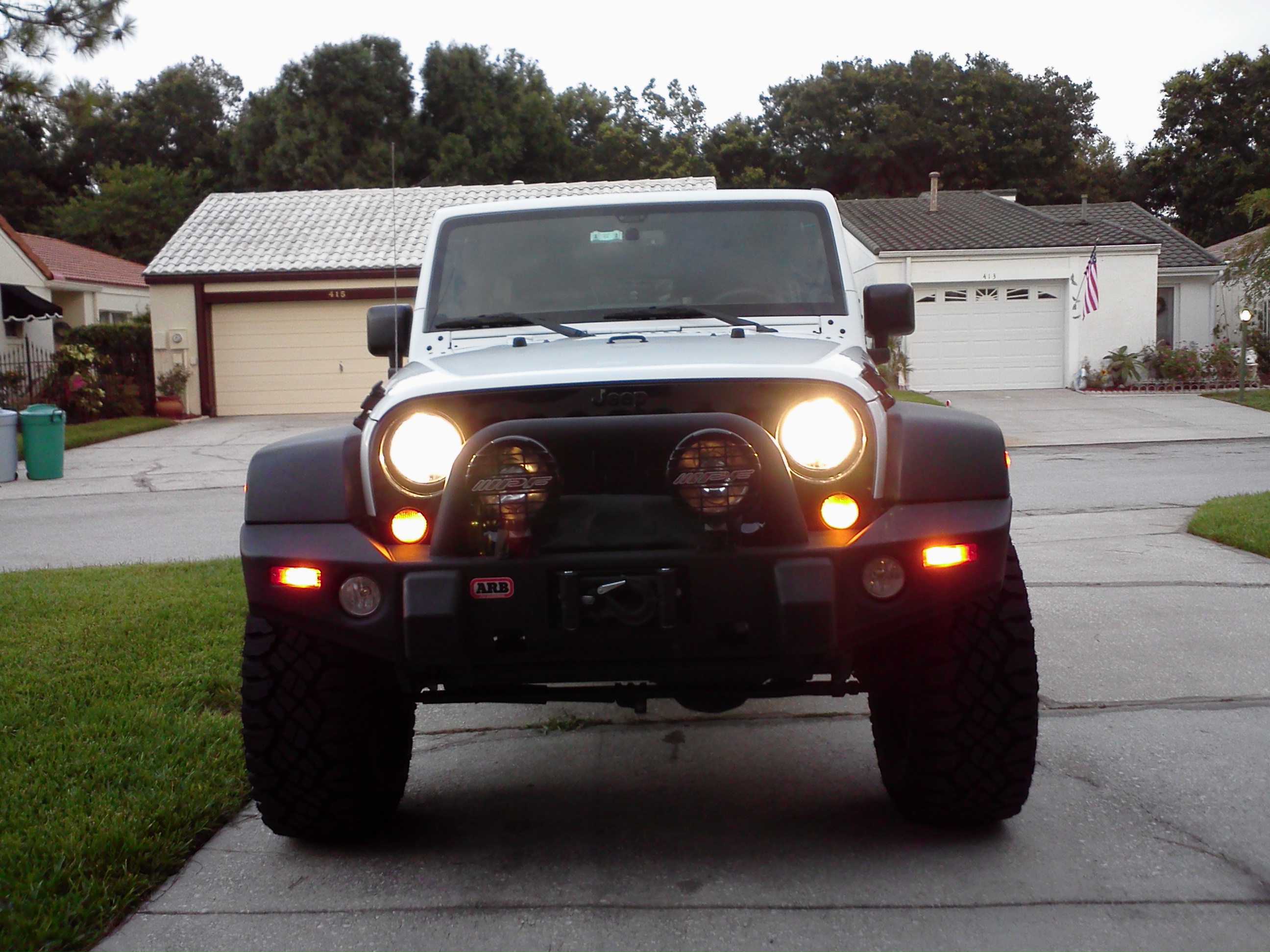

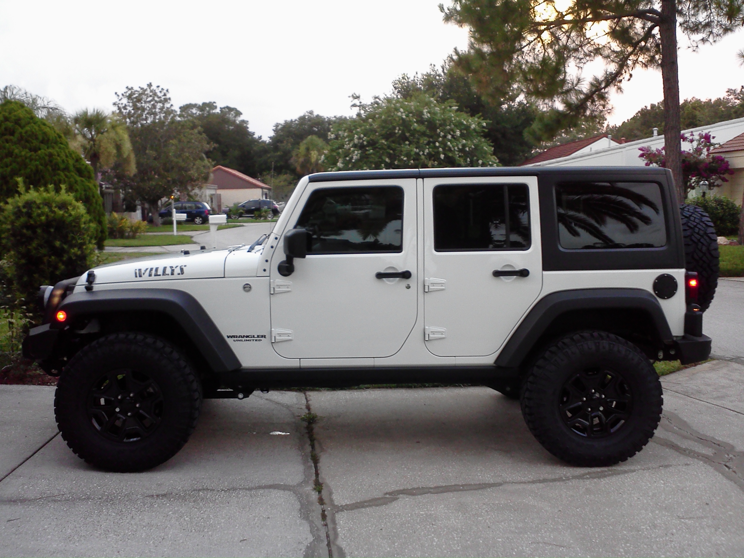

Really depends on how you are going to equip your JKU. I installed the first July the AEV 2.5" DualSport XT Suspension with AEV Geometry Correction Front Control Arm Drop Brackets and Spidertrax Black 1.5” Spacers with Factory Willys Wheeler 17” Wheels and Goodyear Wrangler DuraTrac 315/70/R17 Tires. I gained 3.5" from my factory Willys/Rubicon Suspension. That is with ARB Deluxe Front Bull Bumper and Smittybilt X2O-10K Waterproof Synthetic Rope Winch which weigh over 180lbs. The rear I have ARB Rear Bumper with Tire Carrier and tire/wheel and weigh over 195lbs. My suspension has not sag and almost level. I use it as a DD and driven over 2000 miles and the AEV Suspension and tires handles and rides great. You see a lot of positive feedback on AEV and the reason I went with AEV because of the heavy bumpers I installed on my JKU. Watch YouTube Video on how JKU handles with AEV 3.5 Lift and 35s on a road track - https://youtu.be/HbKniB2gkl8
