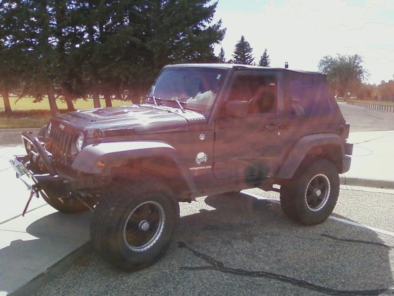

Any one got ideas, pictures, ext, for a good in between Overlander and Rockcrawler and to make matters worse ITS MY DAILY DRIVER
Also it's just me going. My friends always take there trucks and I havent found a Mrs. Slob

This helps alot! thanks guys. I know now what I want to do with my JK and know now I am really far from getting there
But maybe one day My JK and my funds will be ready for a total epic adventure like the JKX
