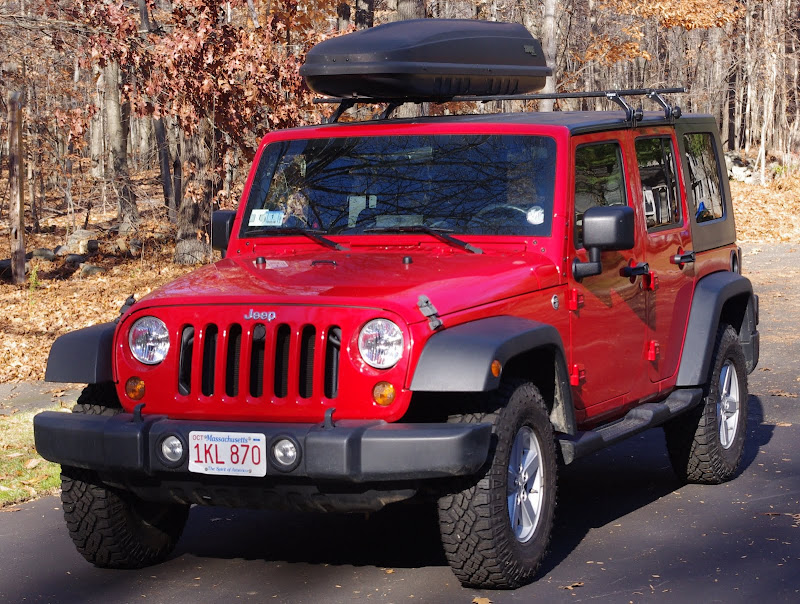

From the title of this thread you will get that I am into Overlanding, a fancy word for the love of traveling long distances over every sort of terrain and "getting lost", while still "getting there". From my tag you will get that I am not in a hurry. My almost-stocker 2008 Rubicon Unlimited will be even less stock very soon, but it has several thousand of these kinds of miles on it, buried in the 45,000 miles of SoCal commuting and Interstate travels. And all that means, is that I need new tires.

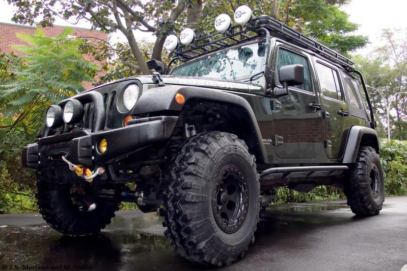

"21st Century Tires is a manufacturer, wholesaler, distributor, and exporter of new tyres, inner tubes, flaps, valves, batteries, and wheels for just about any vehicle."
According to this website, they have a distributor in the US. :
If my Jeep did not have to do DD duty, I would have these tires!
(16 in rims max, though.)
