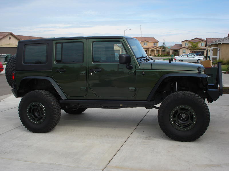

Default P.S.I. 37" km2s with beadlocks
What p.s.i. are all of you running on you 37" if its to high will i get more bump steer?

ill have to do that there 9" wide

I have Toyos, 13.5 wide on 17x8 rim. The tire dealer had them at 35 psi and they ran way to harsh and it rode really squirly on the highway. I lowered them to 31 and made a big difference in handling and ride comfort. I could probably go down more to like 28 but so far it feels good where it is now.

I run mine at 28 psi. 12.5" tire on a 9" rim

I can't believe that the edges of the tires touch the road.

37-12.50 on a 9 " rim and right now I'm running 34 PSI. I like it so far but its also only been two weeks.

2 door here, heavy bumpers winch etc. I keep mine between 28.5 and 29 psi. I have 38000 miles on this set with pleanty of tread left for another year or so. Rotate'em at every oil change and they will treat you well.

thanks for the info i set them at 28psi and the jk handles like a dream
