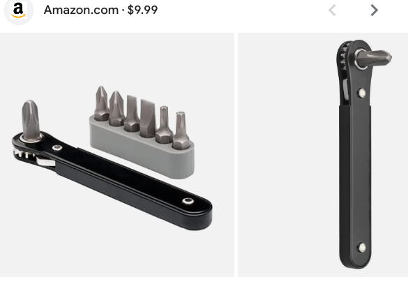

Well, i'm not going to lie, the two rear-most bolts are right over the exhaust and the cross-member. They can be a pain to access, but for me the secret has been using a small bit driver like this with the appropriate torx bit -
My exhaust has been rerouted so it's not in the way.....but my buddy recently did this service and his exhaust is still there and did not have an issue after sucking as much fluid as possible out through the dipstick tube. If you don't do that then well, it's a complete mess with tranny fluid spilling all over. My first service I attempted a "controlled spill". I'd stress "ATTEMPTED"! Also, if you use mittyvac to pull the fluid out you have an easy measurement of how much fluid to put back in. We typically just do a simple drain/refill with a filter change.
