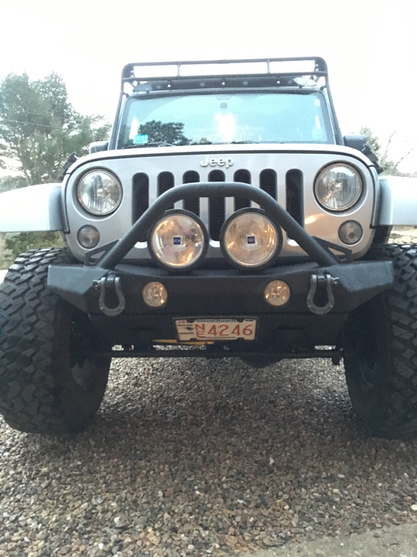

If you prepped the bumper and grill before you bed lined them, a simple rub down with acetone should be plenty. I had my bumpers sprayed with Line-X then I sprayed them with rustoleum gloss black which makes them easy to keep clean. Every spring I rub them down with acetone and hit them up with another coat to keep them looking fresh
