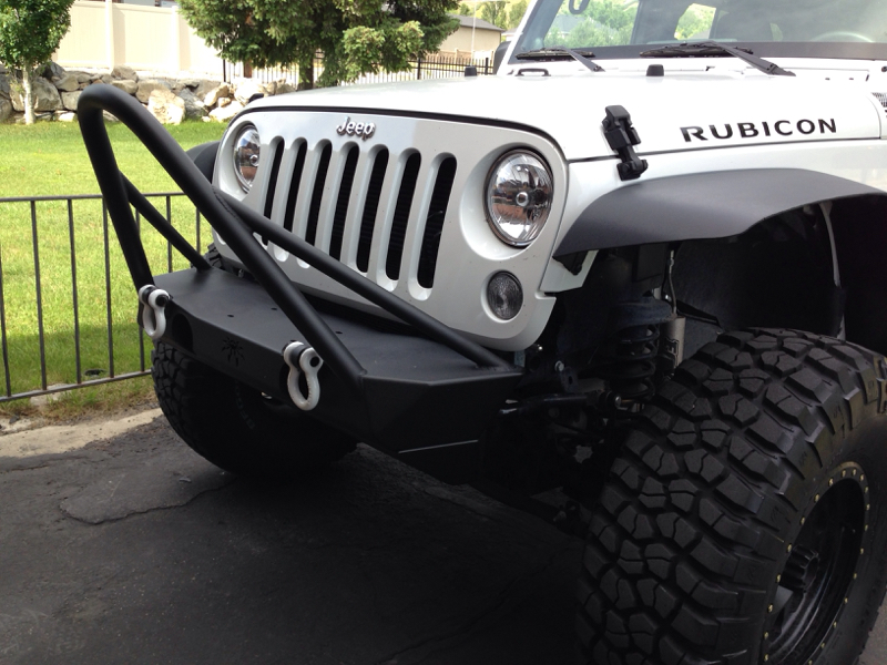

For those that have painted your grill, how did you do it? Was there any prep to it needed or did you just paint over the stock paint without doing anything? I'm wanting to paint mine black. I've got to pull the bumper off to put on my wench on and figured I'd do it then. Also, should I go flat or glossy black or bedlined?

If you want to go black.. Why not just plasti dip it. You would spray it on just the same as painting except no prep work. Just spray on several coats and let dry. If you don't like it you can just peel it off.

I scuffed mine up with a scotchbrite pad and then degreased it with rubbing alcohol before paint. For paint I used rustoleum truck bedliner spray. It's been 4 years and it's held up great. I'm surprised it hasn't faded at all. My factory fenders were severely faded in 2 years and everything I have used that rustoleum bedliner on has held up perfectly.

I did this exactly..has held up great for about 3 yrs.
