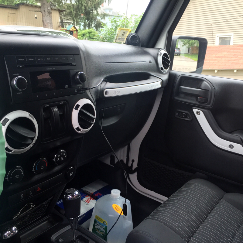

So I found a video on YouTube of a guy showing how to take the vents out. After I watched that I realized it was SUPER simple. In the video he plastidipped them which I originally didn't want to do but for now it's the cheapest option so I went for it. I love how it came out! I'll probably do it over with real paint eventually but I love it for now! I just hope it lasts.
