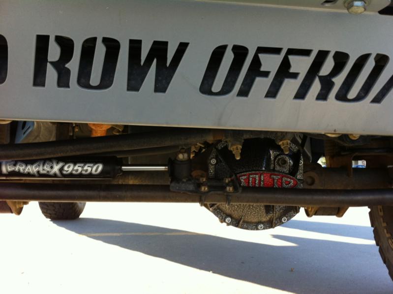

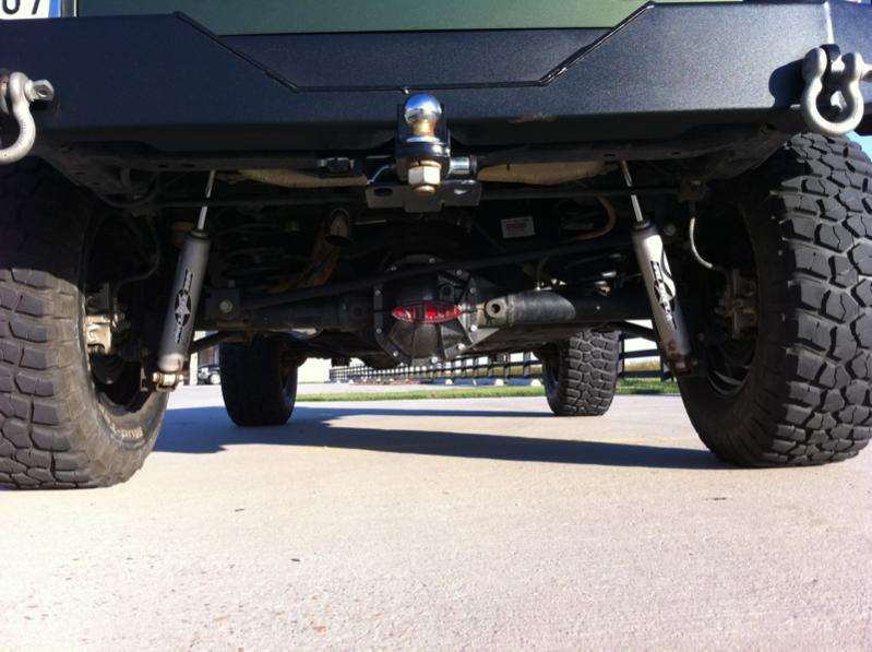

Auto paint works well. Did mine about a year ago. Still great and I wheel frequently and pretty hard. I did 4 coats though. I have better pictures of the covers off but I'm on my mobile. Here's what I have on my phone:
ID:	256134   Click image for larger version
