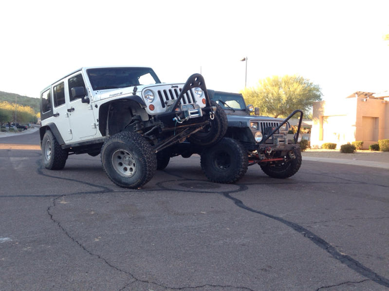

Well here it is. I will be sure to post up after wards.
