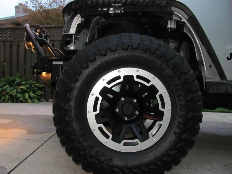

I used Duplicolor in the matching Bright Silver for my fakies!

Originally Posted by 08jkfreak
<img src="https://www.jk-forum.com/forums/attachment.php?attachmentid=399620"/>
Any primer? Sanding/scuffing before hand?
all of the above

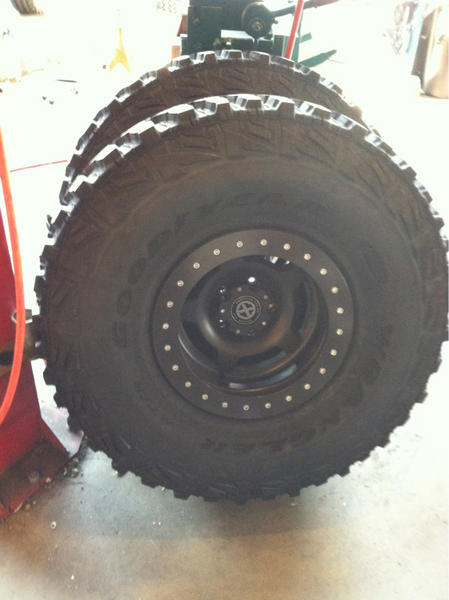

Yes, all the above.

Just painted my ATX slab rings...
First, use 320 Grit sand paper,
clean real good with cloth.
Then self etching Primer 2 thin coats (10 mins in between)
Next, 1000 Grit sand paper to primer.
Then I used VHT satin black rattle can in 2 coats (10 mins in between)
wait 2 hours then a final wet coat (spray side to side quickly but spray till it glosses and has a wet look)
Make sure you dont spray paint in the sun. room temp is optimum.
Wait several days to fully cure...
Clear coat optional, I didnt use it so I could touch it up easily.
Came out perfect and matched the satin black to wheels.
