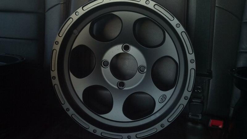

If all else fails you can take them to get media blasted and powder coated. I did this with my wheels for my rhino and they turned out great.

Those look great!!
