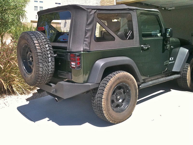

Here is another shot of the rear. To install this correctly on my wrangler I had to fab a 1/2" spacer plate to go between the bumper mount and the crossmember. with the spacer it bolt up perfect, without it it comes up tight against the body pan before touching the the frame crossmember.

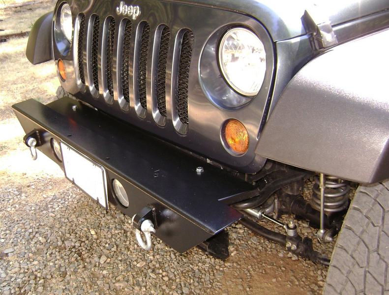

It's a great front bumper i do not have the Rear. Its stout

Yeah I love my PE front bumper, super strong and ofcourse the unbeatable price!Click image for larger version
