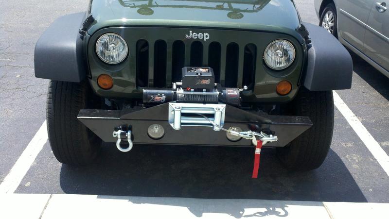

Default Here is mine
Here it is with the winch mounted. The winch plate is separate and costs around $70 or less. I love mine!!!Click image for larger version

If you mount a winch, you have to remove the top side plastic. The bottom side plastic has to come off for this bumper to go on. With mine, you cannot really see between the winch and the grill as it is almost a flush fit. It was really easy to install - Really easy. The only difficult part was getting the factory nuts off the OEM bumper. Once they were off, it was a 15 minute job - 10 minutes were de-installing and re-installing the factory fogs. Just putting on the bumper was 5 minutes - 8 bolts. The winch and plate was about an hour job total, with the most difficult part being the wiring. If I had not put all four winch bolts on when i mounted it to the plate, but before the plate was on the Jeep, causing me to have to take it back off, it would have taken much less time. If you mount the winch, wire the winch BEFORE you put it on the plate. Then only install the two rear bolts holding the winch to the plate. The front bolts run through the bumper and plate into the winch. I wish someone had told me that.

Here it is with the winch mounted. The winch plate is separate and costs around $70 or less. I love mine!!!Attachment 187496
That looks great! I want one!
Anyone get the rear bumper to match yet? I think it just came out...
