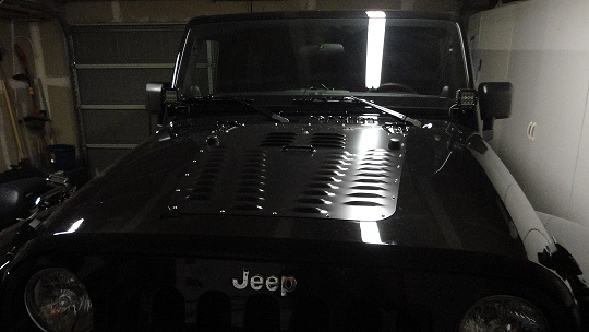

Its not as bad as you think and your butt hole stops puckering after you drill the first hole through your hood. Take the hood off its much easier and you can get above the hood when cutting. Do not over tighten the bolts as it will dimple the hood. Definitely paint all the bare metal including all the holes you drill for the screws.
