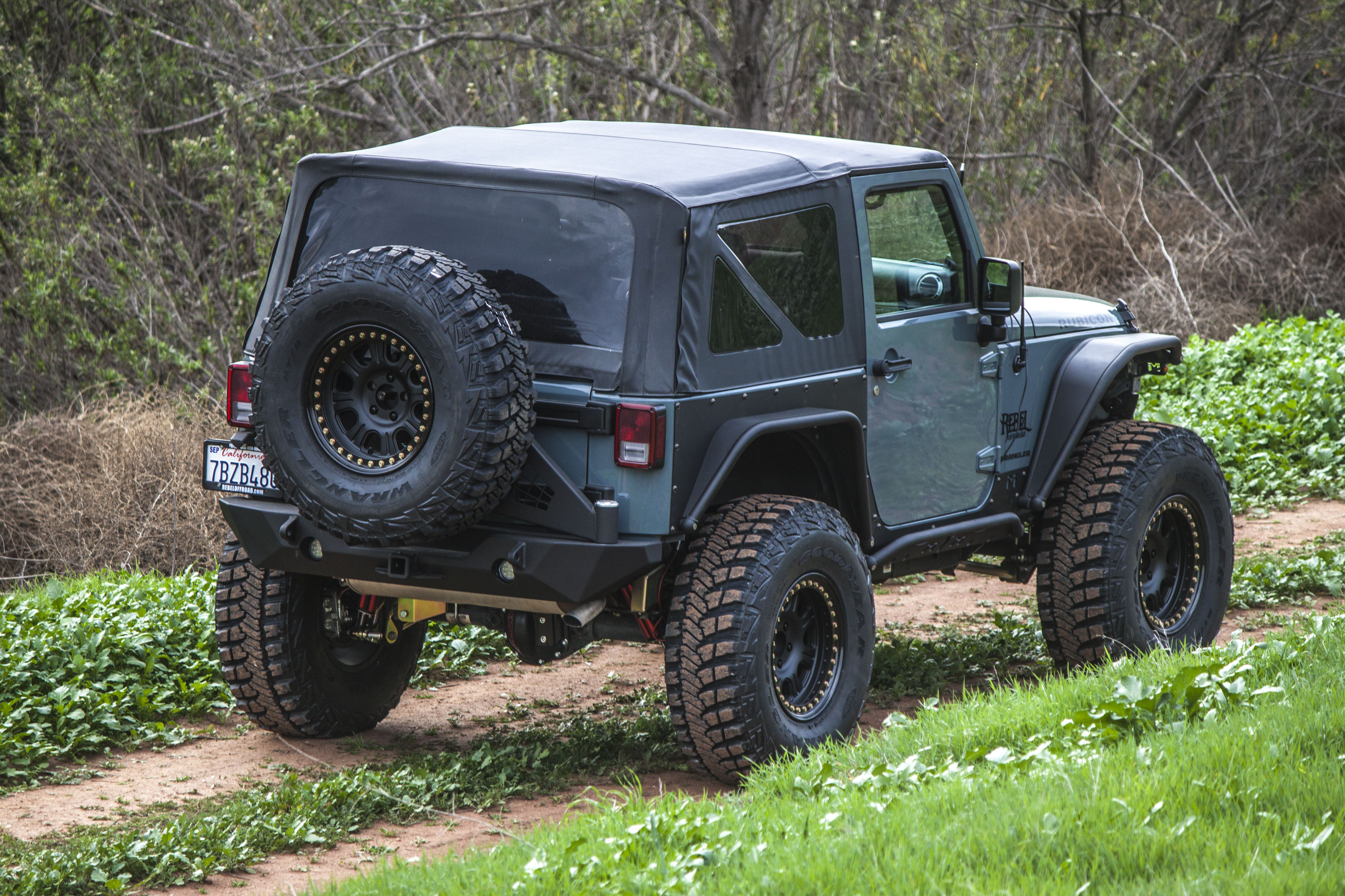

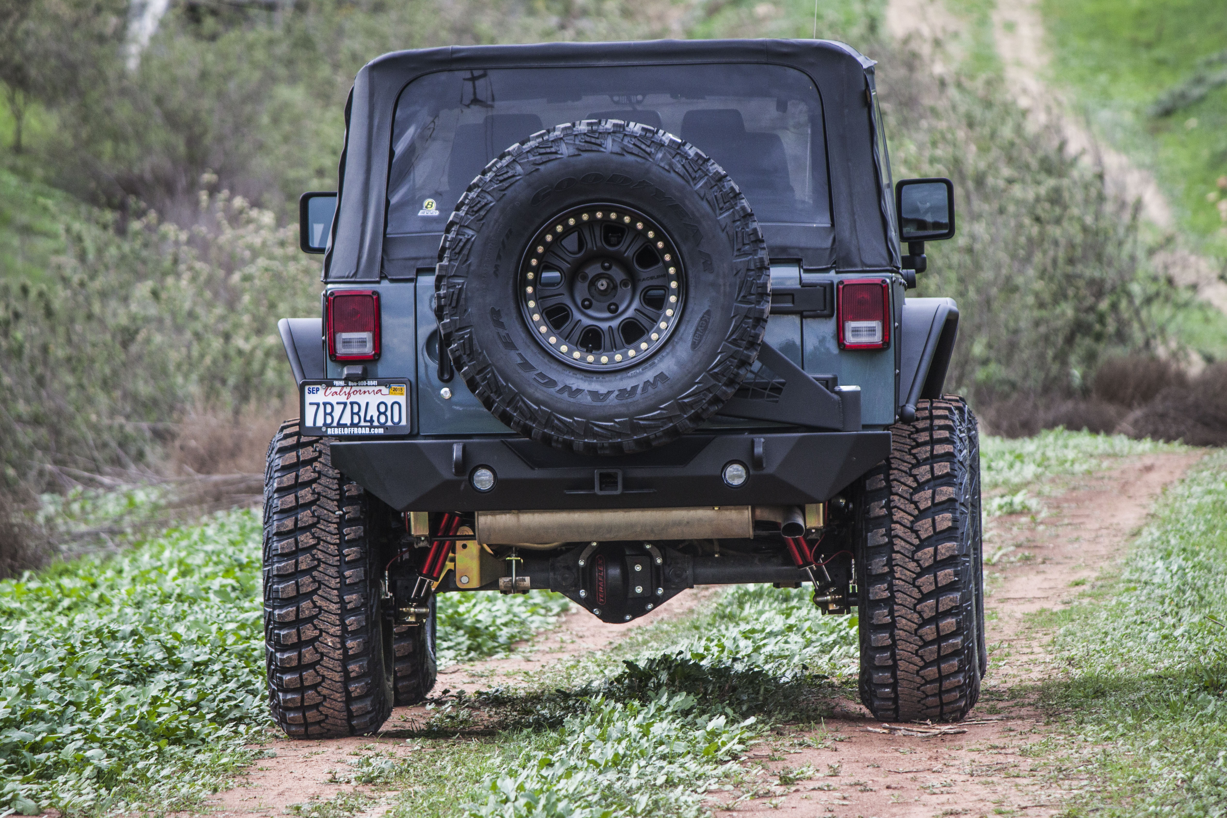

Thanks, yes, agreed, I'm running the full Synergy HD setup. Not sure if you are familiar with it or not, but, it's very stout. Shop I deal with has been in business for 50 years, sell just about everything under the sun, and they commented it was the most stout, fullest coverage over the counter setup they have ever dealt with. If you are shopping, take a look.
MC sells just coils, so if you change your mind later, just sell the 3.5 and get 2.5. Unless you flip the drag link, then you're pretty committed.
My rig was reasonably weighted and I got exactly 2.5" of lift front and 2.75" rear. I'd guess you'd be 3.6" front and 3.8" rear.
thanks Invest.
The build sheet on the rig in the photos is near identical to mine (found on another popular Jeep forum)... I have a heavier belly, he has metal fenders and rear tub slabs... otherwise we are the same sprung weight... maybe he's 80lbs heavier overall.
Agree, I can swap coils later... but, the flip will eat up - up travel... bah.
I do run with a lot of gear in the rear when wheeling...
