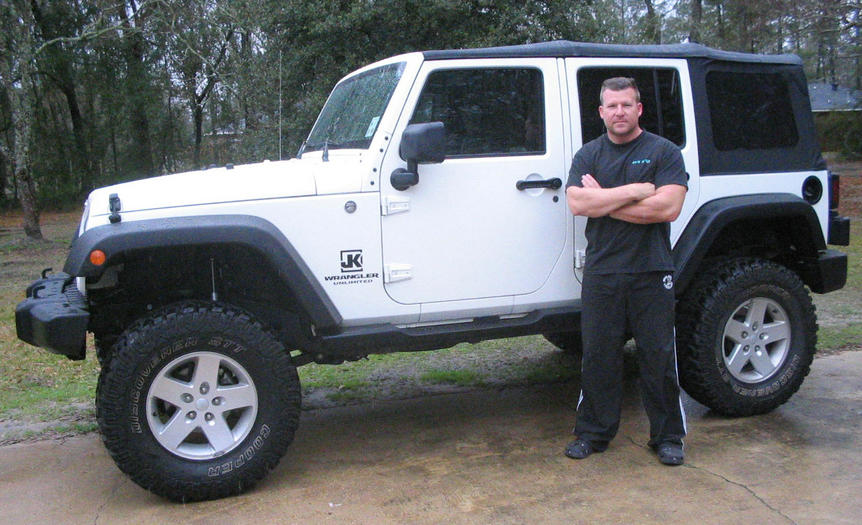

The super lift will be to tall for 33's. The TF 2.5 would look alright with 33's but it will fit 35's almost perfectly.
My Super lift with 35's, also has a 1in body lift, this was right after install
