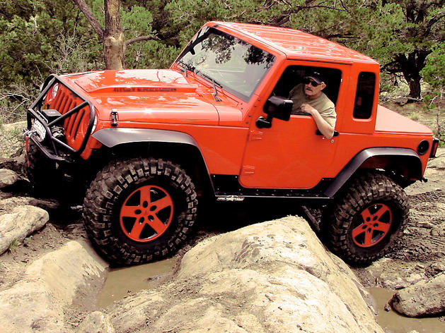

Avenger Superchargers makes a pickup-type conversion. Go out to their website and scroll to the pics on the bottom. That one has a cover over the bed, but I saw one that was open and bedlined not too long ago.

I saw the one from Avenger this year at the Hi Country 4x4 open house. It's pretty nicely done. It was the orange JK with the bed cover. If I remember correctly, the top and bulkhead was around $1500.
