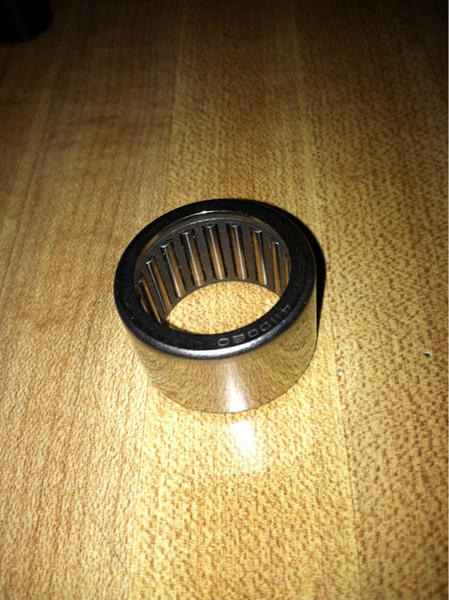

IN the last two months I have had to pull trans on my jeep twice both times throw out failure .... But the second time the pilot bearing failed. Then the through out failed.
Has any one had similar issues or is there a better bearing...... Or has any one tried to use a bushing.
Here is a pic of a new bearing like the one that failed..... And the jeep house mechanic said he thought that the mopar bearing had a seal this one does not and I the other has not come in yet.
Thanks for any thoughts or solutions .

I've heard really bad things about Mopar bearing an dont buy them. Just from reading post on here go with national bearing much better quality an more reliable

Your problem isn't very clear. You say that the throwout bearing failed twice, but the second time that your pilot bearing failed. Did you change the pilot bearing the first time? How did you determine the second time that your pilot bearing failed? FYI, my throwout bearing failed at about 95K miles. Replaced it and the pilot bearing and am at 125K miles now. OEM parts.

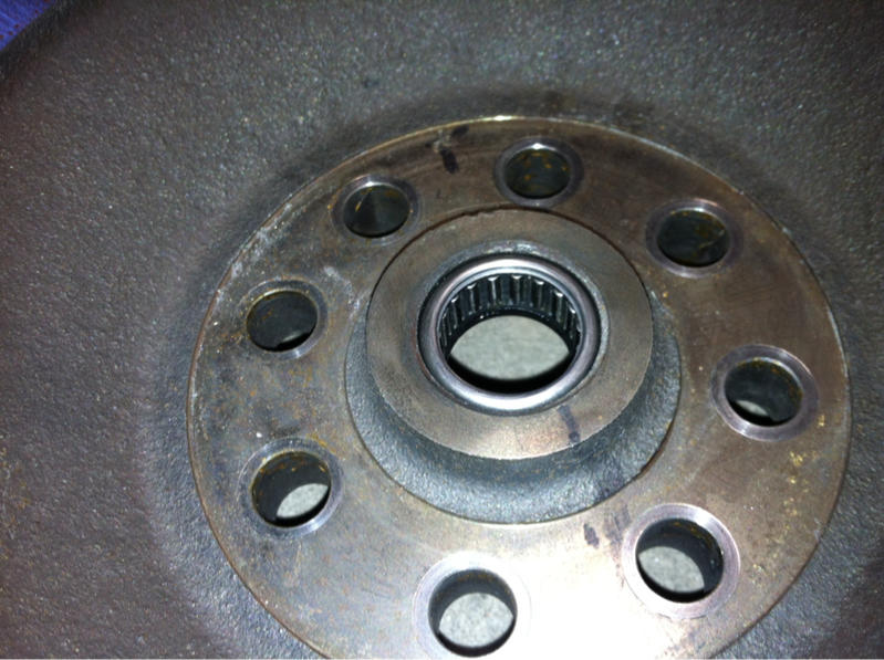

Ok got a Timken bearing # SCE1259 this has a grease seal inside ..... The clutch kit came with a Chinese bearing looks the same but no seal ....I didn't realize this till after pilot bearing failed .... $12 bucks at parts store $18 at the stealership ...
I will try to let you know how it goes
What clutch brand was that? Sounds like one to avoid. I installed a Centerforce in mine, and the pinion bearing and TOB I bought OEM.
