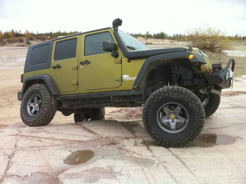

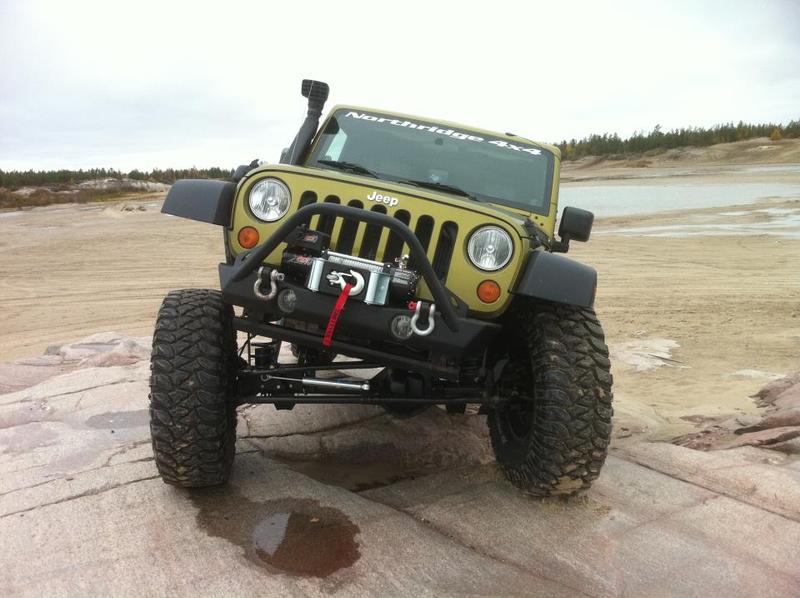

I am running 37" MTZ on my 2007 JKU which is equipped with a 4.5" AEV lift. I trimmed the rocker rails and just a little corner of the pinch. I found that I rubbed just a little that is why I did it. I suppose you could extend the bump stops so that would not happen then you would not have to trim.
