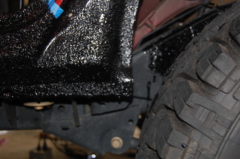

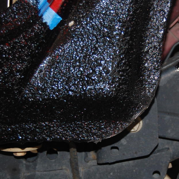

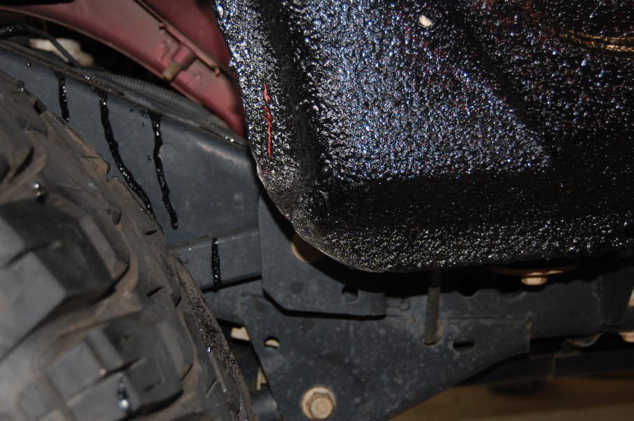

Some have trimmed off more than me, I just didn't want to over do it.
ID:	84576   Click image for larger version
ID:	84577   Click image for larger version
