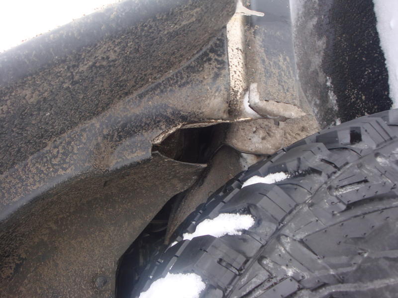

I cut mine to clear my 37's. See pics below. I used a reciprocating saw too.

I also shortened my rock rail.
See planman's write up for some good visuals to help you out.
