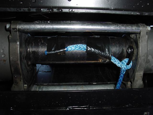

Mine went on my Warn PowerPlant like this:
Name:	Winch Synthetic Rope.jpg
What kind of winch do you have?

Steel cable just uses the the little bolt on the right side, its the wire rope its self that hold it onto the spool and also that why you do NOT unspool you winch all the way and use it to make a pull, you need to leave at least 5 to 8 wraps on the spool.

The bolt is just to get things started. The tail wraps across the spool and the last row of wound rope snugs it down tight.
Wire rope is done similar. There's an eye attached to the end of the wire that fastens by the little screw on the side of the drum.
That little screw can't hold squat on it's own. That why the Warn owner's manual states:
• Never winch with less than 5 wraps of wire rope around the drum, the wire rope could come loose from the drum.
