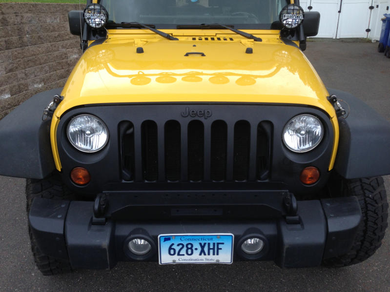

I bedlined mind the other day, i tried plastidip and it didnt work. kept chipping going on trails from branches. just took some 120 grit and sanded it then went over it with 320 to finish it up. rustoleum can of bedliner from home cheapo did the trick and it looks good, even did the winch plate while i was at it.
Looks solid, I plasti-dipped it like 3 days ago, but the coats were uneven and im just gonna peel it off. Thought the clear would make it better o well

Yeah thats the other problem with it, uneven you can easily tell and its the worst when you notice it. least for me, this took me a couple hours mostly prep time. but than you, im quite proud of it, bought the spare grill off craigslist for 100 bucks haha so i can swap to the stock yellow one hangin on my wall when i want to.
