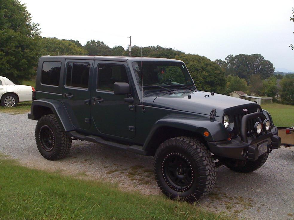

Here are a couple of pics to maybe help...

I don't understand why the dealers don't write down the aftermarket parts. Motorcycle dealers do. Do car dealers think we won't care? Also pics might be helpful. get pis of the shocks/springs especially near the top. get some of the axles. that should help a bunch.

Looks like you've still got the "JK Rake" which suggests to me that it's a budget boost or a body lift. Your best bet is call the dealer and ask him/them.
Or...find someone local that knows Jeeps.
Or...take a bunch of detailed pics of the suspension and let all of us web wheelers here play "pin the tail on the suspension manufacturer."
