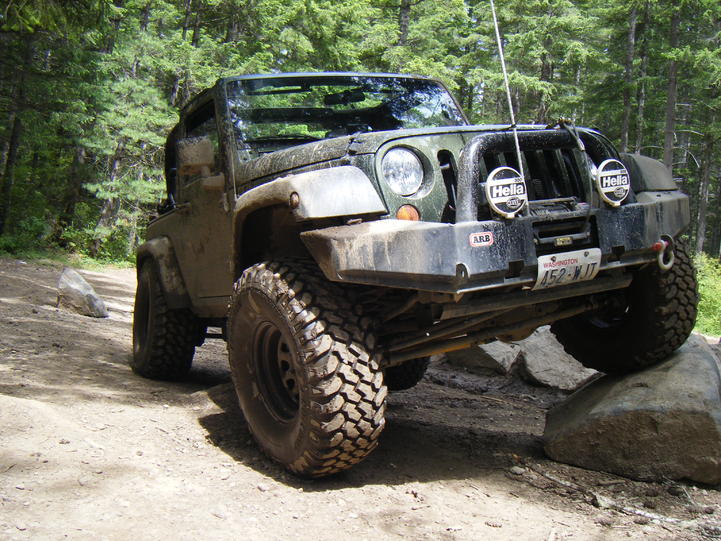

Pro Comp has 15" black steel rims through Quadratec that fit the JK perfectly.
Mine did not require and grinding of the calipers, they fit just fine with 35" pro Comp Mud Terrains.

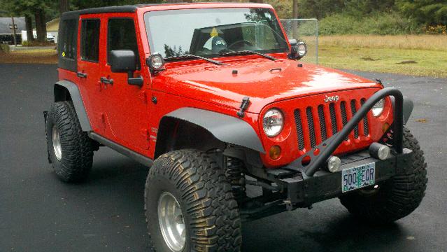

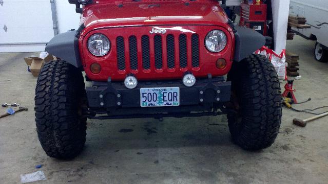

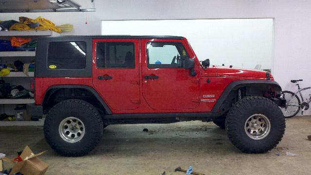

Here are my classic 2s 15x10 with 1 1/2" wheel spacer you can get this style in black or spray paint always works
