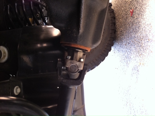

attached rear and front pinion angles, sorry for the sideways photos. rear = 12 degrees at pinion and 12 at DS angle
front is set with angle finder right now at 5 degrees caster LCA are set to factory lengths 22 5/8" and can only go 2 turns shorter on control arms when they were set at 22 3/4" with stock DS caster was 4.2 and 4.4 why does it seem like the caster grew when I went shorter with the LCA?
ID:	165426   Click image for larger version

The lift consists of Teraflex 2.5 (4dr) coils, 1/2" rear spacer, bilstein 5100 sized for the lift, Teraflex monster track bars, front LCA and Rear UCA, still on stock rubi tires and wheels with spidertrax spacers. (yes I removed all of the retainers on rotors)
my rear is dead nuts on, but do you think that slight angle on the front looks like it may cause vibes?

I will also re-interate again, I went through 4 drive shafts before getting a good one. Castor adjustments would move the vibe abit, but it was still there until I got a nicely balanced one. What throws me off is the fact your stocker did it, they are pretty forgiving as far as vibes go. BUT, removing the front ds takes away the vibes, its the culprit if you can't adjust the vibes out and still have descent castor, I run 4.5 degrees by alinement machine on a 4in TF lift, no vibes.
Also, those angle finders accuracy can vary daily.
