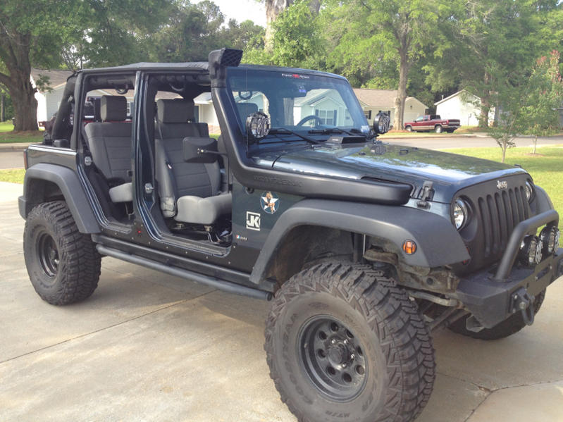

Full disclosure- I run AEV's 2.5" lift. Did the install by myself. For a sub $1k kit, I'm overall happy with it.
Everyone including me seems to love how well AEV lifts handle on-road, so if it truly is a dd then take taht into account. Also, if you really want to get familiar with your rig and this is your first rodeo, one of the benefits of all those brackets and recycling of stock components is that the install may be a bit more newb friendly.
That said, IMHO, I'd stay away from their 3.5" lift. For the price, there are other kits out there, some already mentioned, that give you more bang for your buck. Even though I'm ok with the route that I went, I'm dissappointed that AEV cut a lot of corners with their 2.5" kit to supposedly get it under a grand. You're paying a lot of money for what many will argue is great marketing (read: hype).
